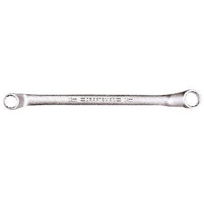

the hardest thing you are probably going to run into is the 12MM 12 point fasteners on the rear driveshaft flange..
you will probably want a quality box end wrench..
00942956000 1?Wid=400&Hei=400&Op Sharpen=1&Qlt=75
Craftsman 12 x 14mm Wrench, 12 pt. Box End
item #00942956000
Mfr. model #42956
sears, kmart, osh stores and some hardware stores sell craftsman..   there are other professional brands..  and a few of the imported brands are ok...
you will also want a combo wrench in 12MM 12 point... so you can use a second wrench wedges through the open end to extend the wrench even longer..   having somebody sit in the car and depress the brake pedal or using the parking brakes to lock the rear axle..
