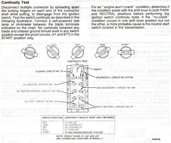

start at the ignition switch...
Fordignitionswitchpinouts
could be bad...
blower control voltage usually comes from  one of the A2 terminals...
about the P terminals  P2 and i seem to recall the single end.. in the crank position.. those are grounded... so the oil and temp light circuits are grounded as a bulb check..
i don't have the HVAC wiring diagram handy for that model... probably vary similar to other models..
you can get it from eautorepair dot net   sometimes you can google it..
the low speed positive vent system is probably also controlled by a relay... it is on other cars...
