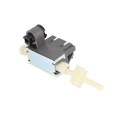

since you seem to have a manual transmission..
was your car originally equipped with a manual or was it an automatic car...
is the computer for an manual transmission..
is the clutch interlock switch working ..  i have forgotten what year your car is..
its not shown on many generic wiring diagrams..
