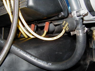

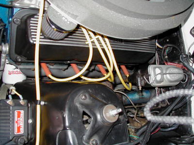

Fits mine pretty well.  The only modification I have done to the motor mounts is to drill them through and weld in a 3/8 bolt to hold the pieces together.  I also have an engine limiter since I race the car.
Here is a page I never finished that shows head clearance - click here
Need to re-shoot all these images, all old scans.
