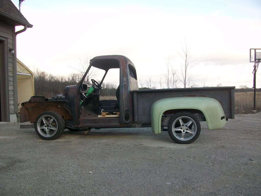

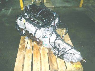

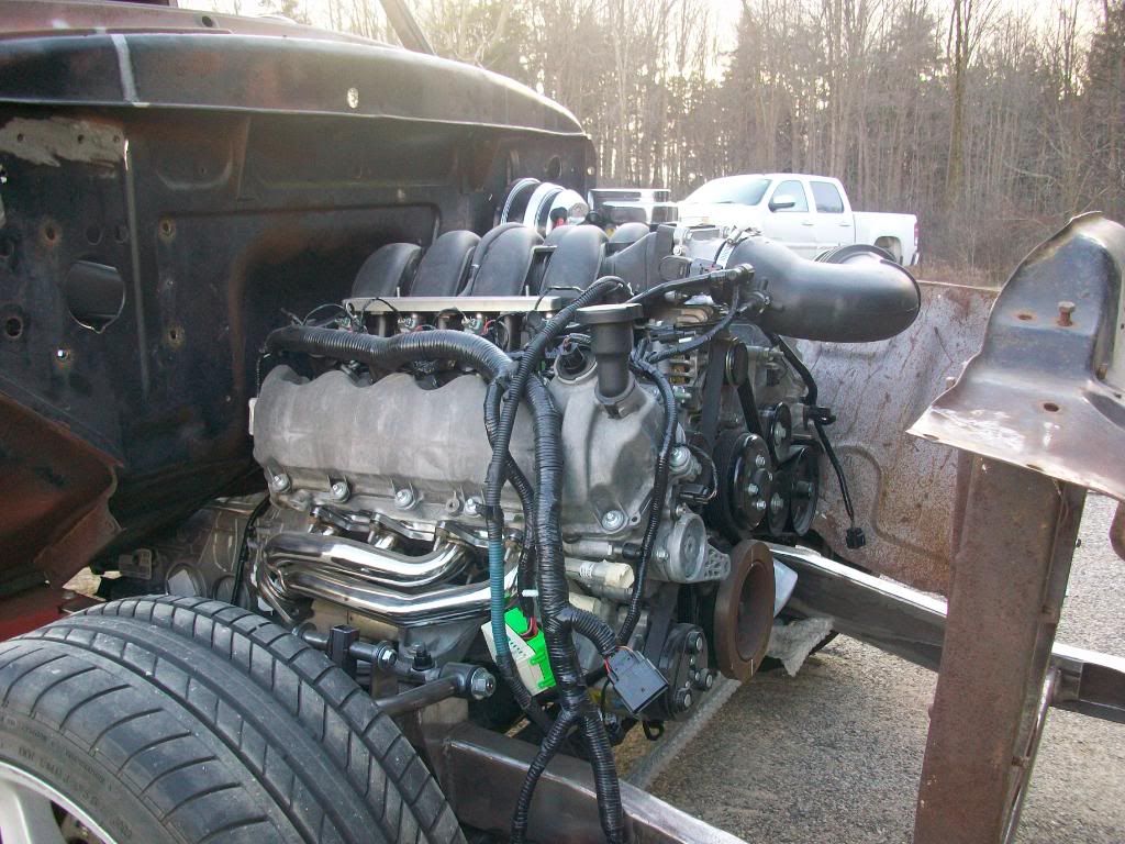

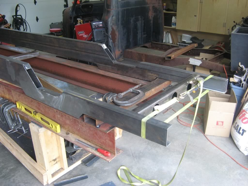

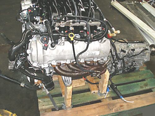

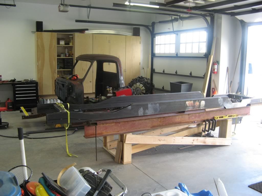

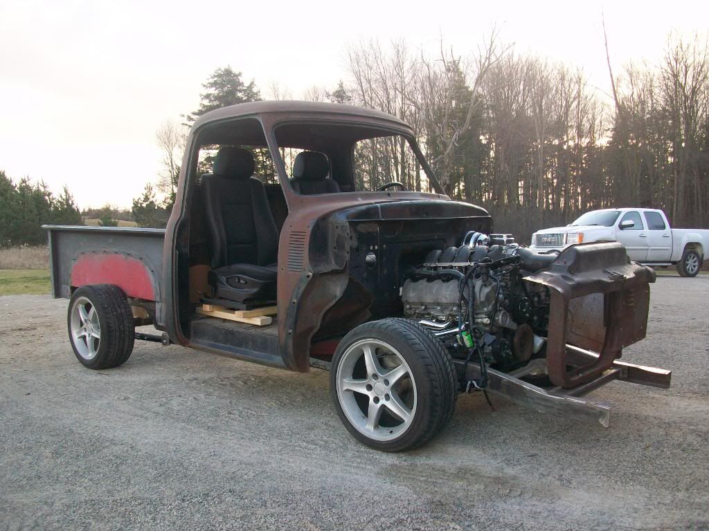

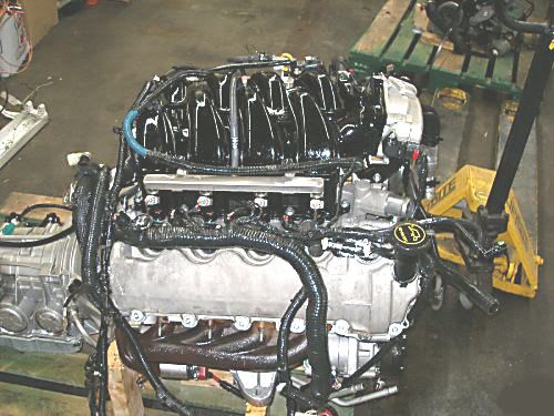

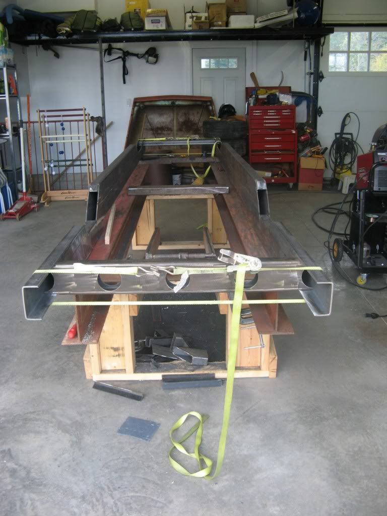

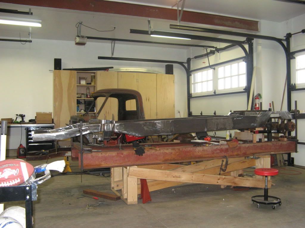

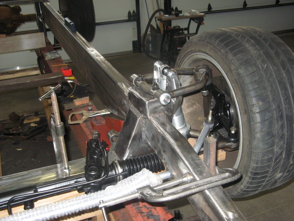

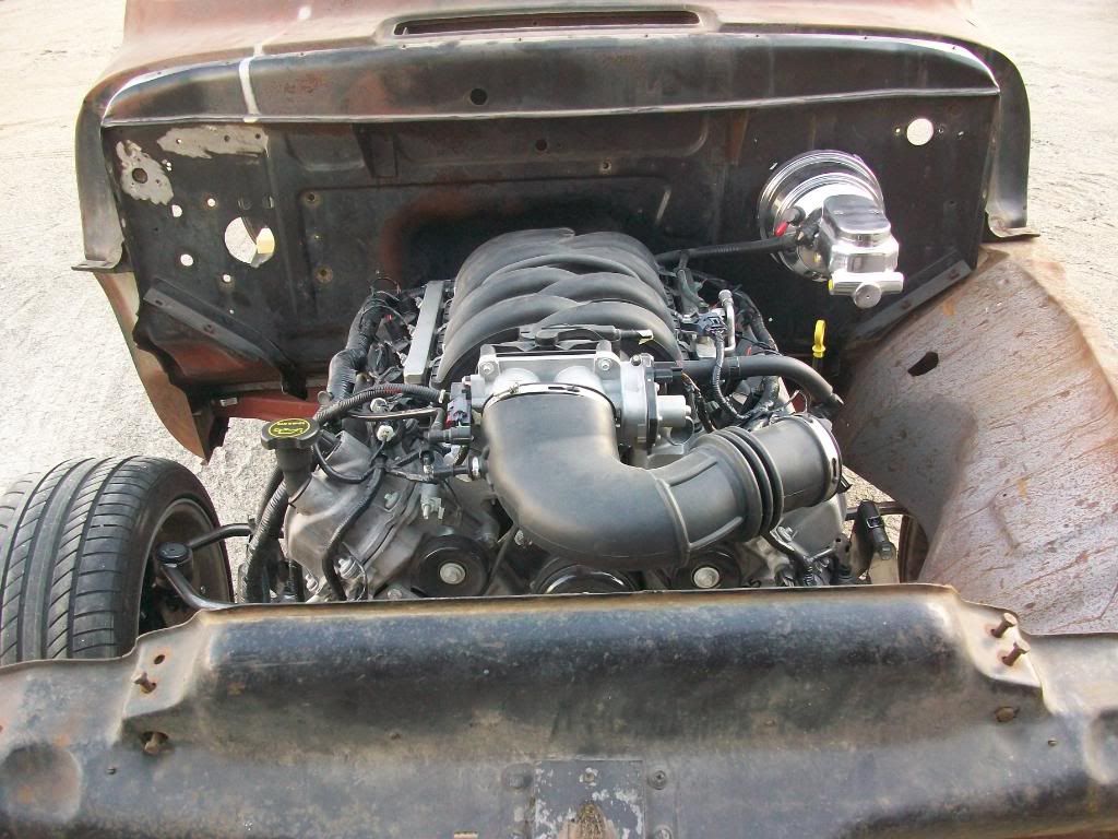

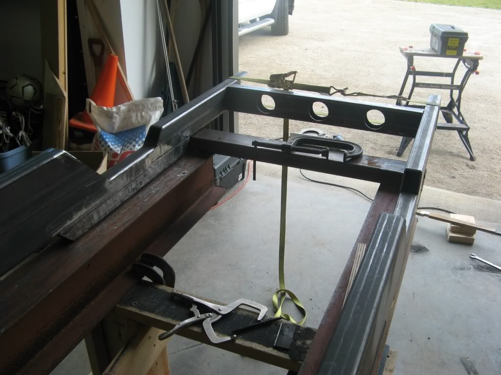

I am currently installing an 2006 mustang driveline into my 53 f100. I have been waiting for Ford to release an ECU and harness for this conversion but as yet they only have it for the manual trans. I see you have the same driveline in your 68 mustang project car, how will you be controlling the engine and trans? reprograming the original ECU? I've waited for over a year and now that the new 5.0 is out I don't think Ford racing will bother with the 4.6 3 valve. It would be greatly apreciated if someone could help me with my problem. Thank you!
here are some pictures.
