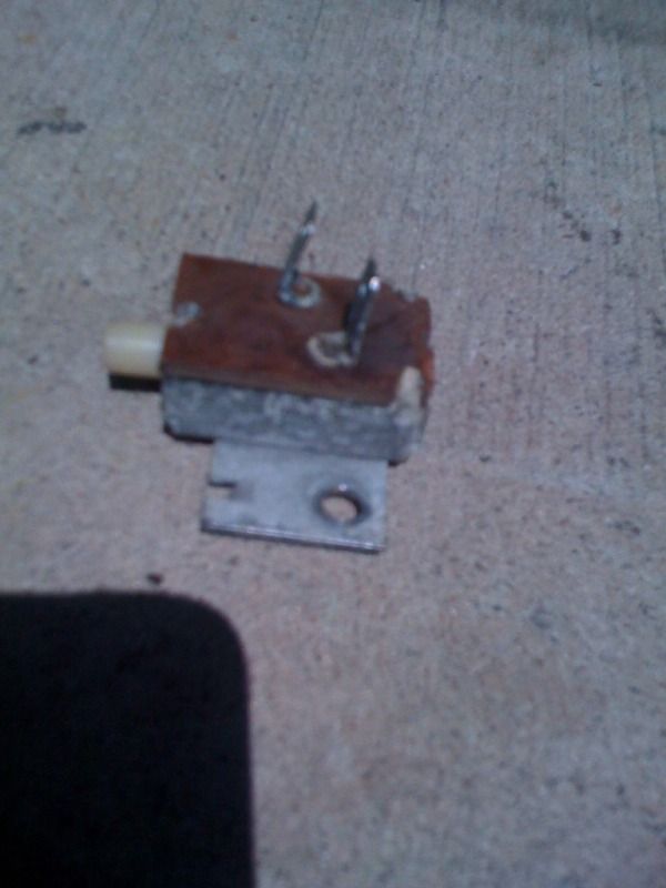

this is the only image i can find of the possible switch..
it seems to be mounted on the blower motor... looks like a push button of some kind...
how does it turn on and off?????
unless its hit by the throttle linkage under the dash at wide open throttle to turn off the compressor when you have your foot close to the floor...  to release the compressor clutch and stop you from blowing the rods out the side of the AC compressor..

Did you get the switch figured out? Just rebuilt my heater / ac box. Can send pic if still needed.
waynep71222 waynep71222
User | Posts: 58 | Joined: 04/12
Posted: 03/07/13
08:10 PM
Too many projects.. we welcome any help... or images...   you can upload it to some free image hosting site like photobucket dot com.. and then paste the links that start with img here..
