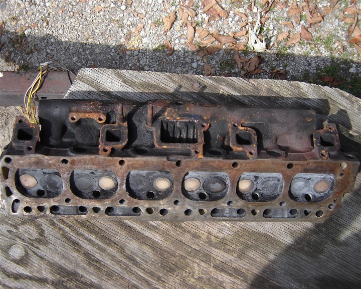

first...   there are FREEZE plugs in the side of the head behind the exhaust manifold as i recall.. could those be leaking???  there is probably one at the back of the head also...
please do a compression test.. before taking the HEAD off...
early heads have SOFT valve seats...  there is another way...
ford made 200 motors as i am guessing thats what you have up through 79 or 80..  the 70 up engines used a larger carb mounting adaptor..  there is a company who sells to engine builders.. has this neat adaptor   its a part number CA200 from engine quest..
this allows you to use the later heads that already have hardened seats on 69 and earlier models..  this would allow you to buy a reman or some way source a later head and make it a bolt on..
before you unbolt the head.. you might also want to check the lift of the cam.. on all the different cylinders.. to make sure you DON'T have a flat cam..  one where a cam lobe has failed.. worn round instead of egg shaped.. failing to open the valves all the way..    if you started the engine .. with the valve cover off.. you could see the push rods twist then stop.. or twist twist twist. in short pulses...  always the same way on each one...
if it spins franticly..  or rocks back and forth.. you could have a cam going bad..  as the lobe is worn down.. the lifter instead of spinning slowly.. either spins at high speed..  or spins back and forth..
while collecting parts .. pick up a tube of permatex Hylomar..  once you are ready to install the head gasket.. spread a THIN layer on both sides of the head gasket.. let it hang for 15 to 30 minutes for the solvents to evaporate..   i hate head gasket leaks and since i have been using this stuff.. i have not had one leak on me..
don't throw out your electronic ignition.. its far better than points if its set up properly.. there are issues with enough voltage to supply it on points type cars. but its not hard to fix that issue.
you can kinda see the hidden locations in the image below
