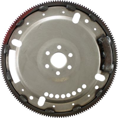

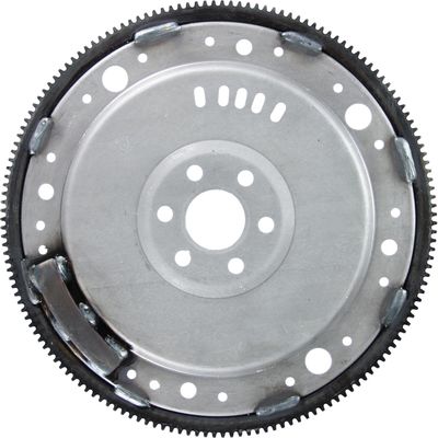

Am installing a 1990 Mustang AOD tranny, in a 1964 Falcon. Using a 1968, 302 small block. Want to know if I should use a 28 ounce flex plate or a 50 ounce.

this is what the 68 mustang 302 came with a C4 transmission...
157 tooth flywheel, 28 ounce inches imbalance..
this is what an 84 mustang/crown vic AOD transmission used.. it is NOT going to work with your motor... the balance will be way off.. this is what bob was talking about.. but..
164 teeth...    50 ounce inches out of balance..
the location the starter bolts up to the bell housing varies with the application...
so if you install a 157 tooth flywheel in an AOD transmission with the AOD bell housing and spacer plate.. the starter will NOT properly engage...
i know that there is a FLEX PLATE to go from a late model 5.0  with the 50 ounce weight to a C4.. you need to do your research.. and i will have a look around the  catalogs to see if anybody makes a flywheel for this swap ...

To drop an AOD behind a vintage 28 oz balance engine (or a stroker 331 or 347, which uses the same balance) you need a 28 ounce balance 164 tooth flexplate. Ford Racing used to sell one, and I believe it was an early '80s F-series and E-series 351W application.
You can also find them in the aftermarket from TCI, Performance Automatic, and others.
I have the Ford one behind my 347 stroker for 10 plus years with zero issues.
