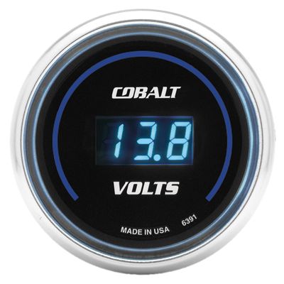

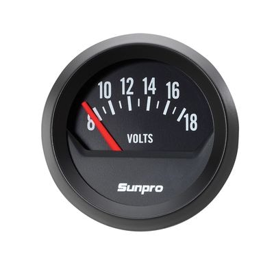

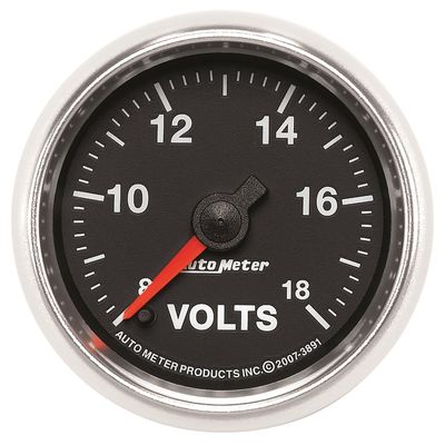

and why would anybody want to install an AMP meter if you are talking about an aftermarket unit that hangs under the dash..
Volt meters are far superior for letting you know the amount of voltage available...
and are MUCH easier to hook up...
the one above is under 20 bucks..
the one below just over 100 bucks..
there are these to make you green with envy.. at just over 110 bucks.. .

oh.. why go digital with 3 digits..
it allows the amount of charge on the battery... and to carefully monitor the charging system..
