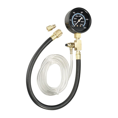

you can hear the fuel pump.... got gas in the tank???    is the fuel filter clogged..  fuel pressure at the fuel rail.. tested with a fuel pressure gauge with the ford adaptor.. does the pressure come up almost instantly or does it take a while...  just because the fuel pump works does not mean it is putting out enough fuel pressure to allow the system to work properly..
this is an actron CP7818 ..  the small adaptor is for the ford schrader  valve.
