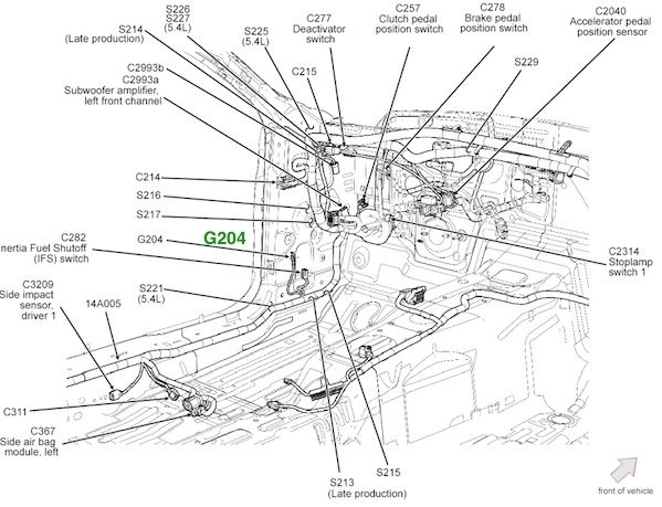

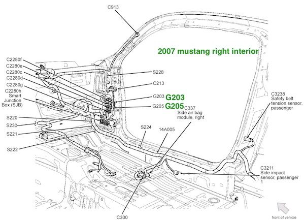

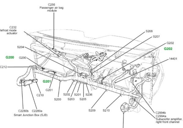

i have a few places for you to clean.. these are for a 2007 model.. but it should be the same as yours..
there should also be a G100 over near the G102 G103.. clean at least the G107 as thats on top of the frame rail..
2007Mustangunderhoodgrounds Zps1559ba45
2007Mustang G204 Zpsa79a09f6
2007Mustang G203 G205 Zps1ea00b18
2007Mustangdashg201 G202 Zpsfd2cd132
i looked at the cluster diagrams.. seems that most are grounded at G201..
so G201 and G107 are important places to clean.. along with the battery posts and terminals...

by the way... the entire dashboard comes out with 2 bolts on one end.. 2 bolts on the other.. then 3 or 4 across the windshield..   please... do all the G200 grounds.. and make sure the dashboard is bolted in tight at the ends..  or run a voltage drop test from G201 to G204 or G205. where its bolted to the body..
you will need to have the digital volt meter on 2 volt or 2,000 millivolt scale to perform these tests... you should get close to 0.000.. but in all reality.. you should get 0.009 just below 0.01 volts..
if you get more than 0.020 you have a bad connection between the places you are testing..  figure it out and clean them..
