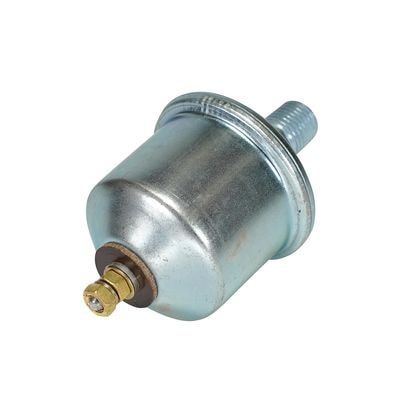

look at the size of your oil pressure switch..
does it look like this???

Thanks for the help and I am just overwhelmed thinking at how big the task is just to replace the oil pump. The oil pressure sensor looks exactly like the one on the photo.

0-4 PSI - Open Ckt
4-8 PSI - 24-36 Ohms
90 PSI - 8.5-17.5 Ohms
with an 88. you are lucky. that you actually have a somewhat working gauge.
the 89 and up models with a gauge.. actually used a reversed pressure switch.. not a variable sending unit..  the later switch is open at 0.. closes at 5 psi... shorts the wire to ground.. but on the 89 model.. there is a resistor in the circuit..  so it brings the oil  gauge up to 1/4 to 5/16 mark...  fooling almost everybody.. rock stable oil pressure..

Wayne, you are correct on the pressure switch just "turning on" the gauge, but that's on the 4cyl cars. The 5.0L gauge cluster and sender still read actual pressure (of course no numbers on the gauge face though).
