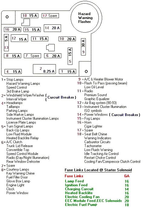

really... an 82... which engine???
my ford manuals that cover this year are boxed up and stacked to the ceiling.. lets see if you can work thru it with slightly newer info...
Fordcruisecontroldiagnosis Zpsfd3e92ae
the cruise control/speed control fuse is the lower right at least in this fuse box ...
Mustangfusebox Zps23fe6c68
Ford 89 Wiring Diagram Cruise Control Zps445fa78a
